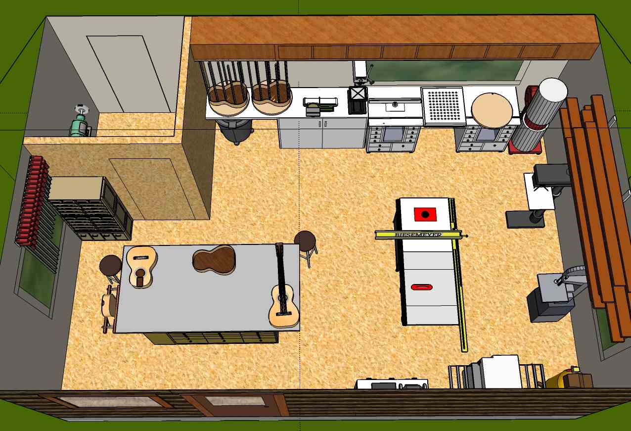

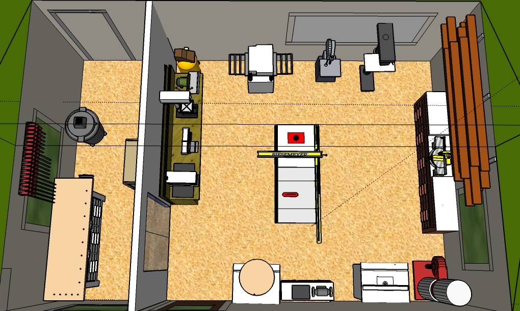

The easiest way to get the tools, layout, etc, is to just go to the 3D Warehouse (I think you go to "File>3DWarehouse>Get Model" or something like that. I'm at work right now, so I'm not sure.) and download this model. Then you can break it up, move tools around, add and remove tools, etc. To find it, search for "luthier". Only my files will come up. The one called "guitar shop reorganization" has these most current models. If you'd rather, though, I can email you the file.
Bob, you'll see I added the buffer!
The "T" wall is not really necessary, it just happened to already be there, so I thought I would use it. Actually, it's just a half wall in the 8' section between the DC and bench. So, I'm definitely open to other suggestions, there. In time, I plan to move the DC and compressor outside anyhow (with return air, of course), but I'm not there yet.
Sooooo...whatcha got?

PostPosted: Fri Sep 14, 2007 3:29 am
Posts: 552
Heavy draw 220V machines will need dedicated circuits, but you don't have any in your drawing... unless that's a monster table saw.
Split receptacles are great for running other stuff too. You can plug your heat blanket & a space heater into the same receptacle & not worry about popping the breaker.
I think you will need more room around your buffer. I would also like to see it further out from the wall.
Also... I would keep your bench grinder in an area as far away from a guitar workbench as possible.
If you ever grind steel, tiny particles will get tossed all over the place. Steel grit can spoil your day if it ends up in the wrong place. It'll probably be fine if you only use it for sharpening, but if you are doing some heavy grinding & making sparks fly...
Same with the buffer. It'll throw polish & lint everywhere.
If you are using the shelf above your workbench as the top of a go-bar deck, it'll need to be built really strong. I have a similar rig & I have beefed it up twice since I first built it.
I am buying some "puck lights" to install under the upper go-deck this week. If I install them right next to the wall, they won't get in the way of the go-bars. The more light you have, the fewer mistakes you will make! (At least that is true for my old eyes.)
If you move your dust collector outside now, instead of later, it will improve the picture enormously... All that wasted wall space!!!

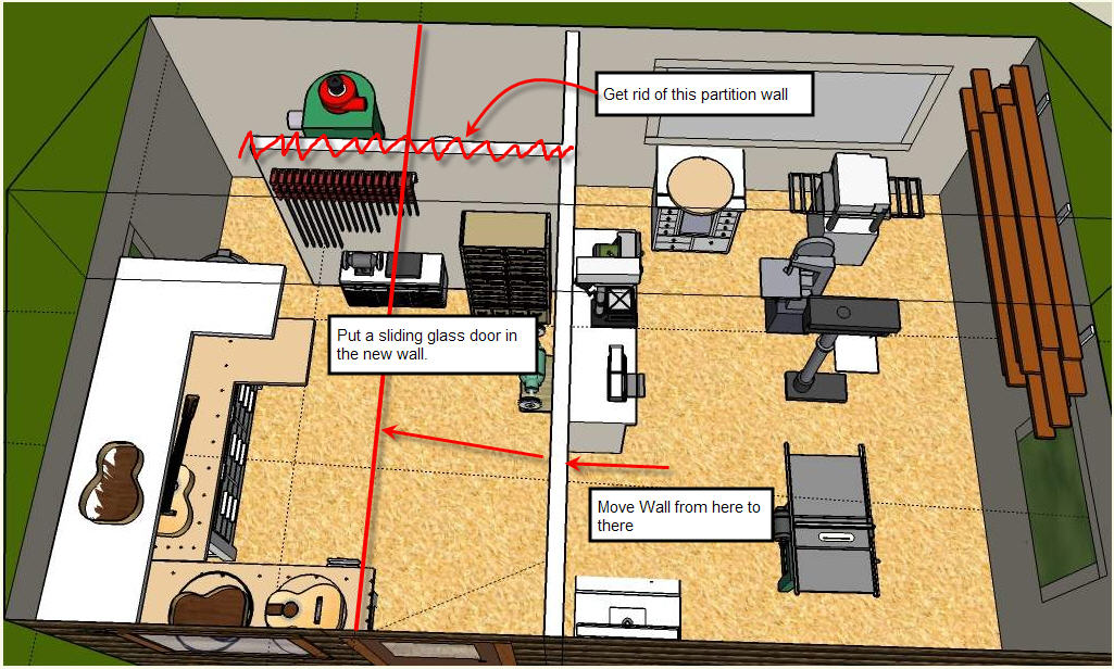

PostPosted: Fri Sep 14, 2007 8:32 am
If the partition walls are not load bearing (which I don't' think they would be) I would get rid of them and move the DC and compressor outside to an exterior room if possible. I would than make the "clean room the length of the east wall to just the east side of the entrance door.
Like this
I think that would maximize the room for the big machines and would give you plenty of space for the cleaner tasks.
That's what I would do If I had that much space. My 185 sft sure feels small at times but I'm glad I have it.

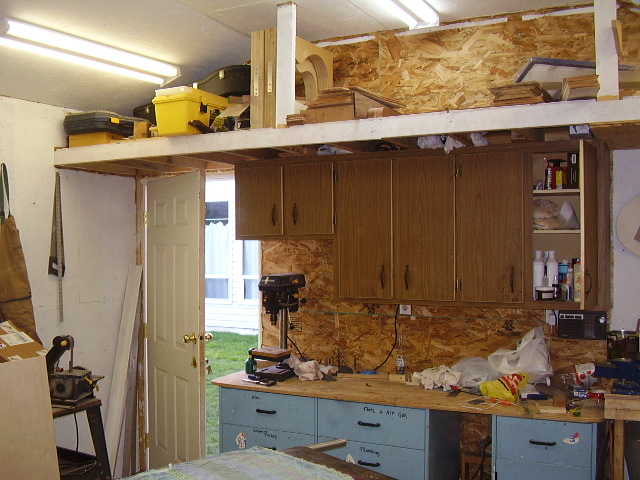

Make as many "loft" type areas as you can for storage as well as upper decks for go-bars as Tony mentioned. You won't regret it.
This is my go-bar deck and loft area combination.

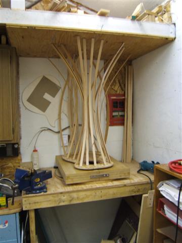

and the loft area above it

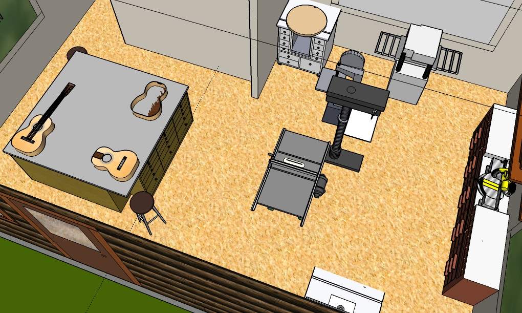

Some interesting things going on with Mario's layout.
1) LOTS of bench space
2) LOTS of cabinet/drawer space underneath
3) LOTS of wall space unemcumbered by benches (and worrying about knocking tools off on your guitars.) Yet, everything can still be within arms reach - at your back or in a drawer underneath.
4) This huge island table (or whatever clean corner of it I can find) still can serve as a TS outfeed should I need one. (TS will be on wheels)
5) Still leaves 3-4' clearance all the way around the bench
6) Has the freedom of using any part of the island as a go-bar area, using an overhead storage rack. Actually, with 8' celings, I probably wouldn't even need one. I rip all my own go-bars, anyway, to whatever length I want.
7) Still leaves the freedom - if someone wanted - to partition of the area and still leave 2-3' clearance by simply extending the end of the T wall. Say with a sliding glass door, like Rod recommended, leaving a more open feel. This would lose the ability to use the table as an outfeed, unless you used like a 5' full pocket door, or something.
Note, this rendition doesn't even remove the partition wall, which would give even more room, if wanted.
Now, this layout does leave less dedicated room than Rod's for shop tools. But, again, my major tools will be mobile, so I can reposition them as needed for more working room.
So, Mario, I take it you're not one who sees the need to separate your assembly area from your major shop tools? I suppose with proper dust collection, it wouldn't be a big thing.

No, Mario, I hadn't figured in a spray booth yet. And, yes, I do spray, so guess if I'm going to lay one out, it may as well be now. I did a little 6X6 room in this drawing. Enough? Seems it still leaves ample room around the table (which I drew in as a simple 4X8). I had another drawing with no wall at all, but thought I'd try your spray booth suggestion.
Mario, you'll see I took your advice on the back wall and set up my benchtop tools as well as a go-bar deck. In a pinch, I'm still hoping I could use any part of the table as extra go-bar space.
And, again, the DC and air compressor WILL be moved outside as soon as I can put together a shed to house them. For now, they'll just have to take up floor space.
Thanks for indulging me in this ongoing post. It really has been an unbelievably helpful post for me! The major parts of my question have already been addressed, I think, to the point that I can plan my major electrical, etc. Guess I do need to work out a spray booth plan and give it some dedicated lighting. May as well go ahead and rip out/put in whatever walls I'm going to, paint, and be done with it.
